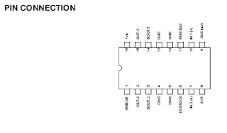

I want to start modding one of my RS medias in the audio areas (Headphones, sub and line out etc). So i un-soldered the heat sinks away from the chips and revealed their part numbers to get info and pin-outs.. I found the data sheets and it seems these chips are sweet little bridgeable amps (arent they cute:).
I am guessing one chip is bridged to mono for the sub and one chip is stereo left and right in the hands.. but i havent verified this yet.
I hope others can use this info to come up with some mods.
