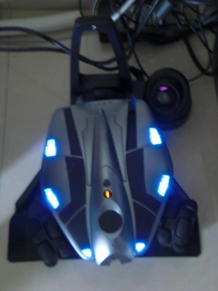

Step 1: Witness Rovio With Blue Lights
Here he is, in all of his shiny blue glory. Let's learn how to tone it down...

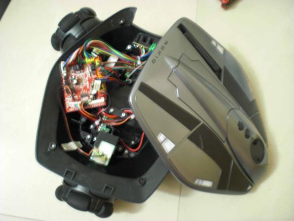

Step 2: Open Up Rovio and Identify the PCB Board
Simply unscrew Rovio's top shell and note the location of the PCB, indicated in this photo.

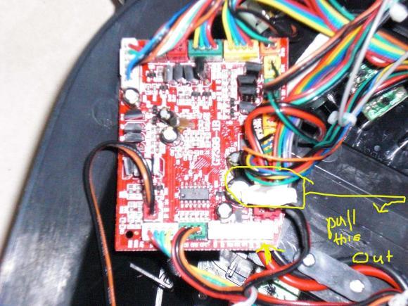

Step 3: Remove The Lights' Connector
Now, you need to locate the wires coming from the lights which end in a "molex" connector that you will need to unlplug from the PCB. You can attach this to the inside of Rovio with some tape, or even wire a switch to it if you have the knowledge (see this post by cowboyctx for more info.)
