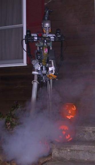

A full scale animatronic endoskull would be a great upgrade for my usual Halloween door guard.
Nice, That's dedication for you.

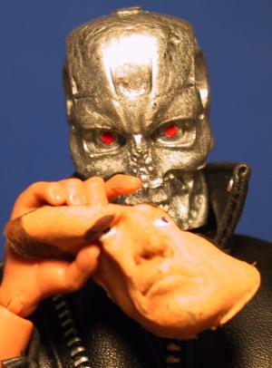

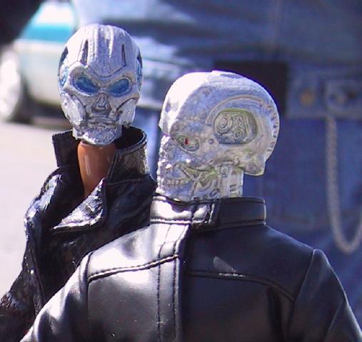

I found that Hammerite hammered metal finish made for a nice 1:6 endoskull coating.
MrScott" Hammerite hammered metal finish: Is that a paint you can buy? Enamel or acryic?
Hammerite is a rust inhibiting auto touchup paint.
I used it over a primer that I applied to the cast resin skulls.
So, you apply hammerite over the metal, then primer, then metal flake powder to what type of base paint?
The small skulls are cast resin.
Over that I applied a spray on primer.
Over that I applied a spray on hammered silver finish.

I just tint the latex when I cast with that. A few drops of acrylic tint it up quite well. The mask the Terminator is holding is tinted latex.
Metallic would be tough though. On the other hand, the metallic portions of the terminator aren't flexible, so they don't need to be rubber.
