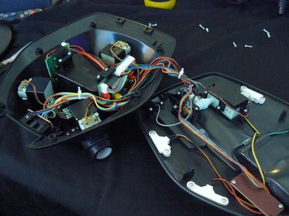

The Opening of Rovio
Obviously, to begin this project Rovio needs to be opened up. With the Rovio turned on, lift the "head" to the full up position, then push the power button and turn it back off. Flip Rovio over (it works fairly well to hold it on your lap with the head stalk between your knees) and remove the battery. With the robot still inverted, remove the six phillips screws closest to the outside edge and store them (coffee cups work well, as do empty egg cartons) Flip it back over, set it on the table, and seperate the two halves of the robot. There will be a wad of cabling preventing the top half from being moved too far from the bottom.

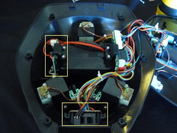

There are two parts of the bottom half that are of interest to this project. Both are outlined in a yellowish color below.
The first is the light array in the "chest" (bottom middle of photo). The outside bulbs are Rovio's InfraRed "Radar". The center bulb is Rovio's default headlight, which I tapped into for control of the new headlights.
A bit of poking about told me the white wire coming from the LED is what I was after. It is the ground for the default headlight, which is apparently switched via the brain board (upper right in photo.) There is a reasonable chance that the existing circuit could handle that extra load of two headlights. For the sake of overkill I used it to switch a new circuit. Since it's a ground to the board, I used a PNP transistor to switch the ground of the new lights. I snipped the white wire near the middle (taking care to leave room to put it back together if all this failed) and connected the board end of it to the base of the transistor through the 2.2k Ohm resistor.

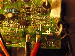

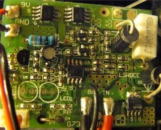

The second area is the power supply board (left middle of photo). This is what the battery and charging terminals are connected to. There are a few convenient empty holes in this board which I soldered directly into. Below is the board in original form, then after I soldered a nice black wire into a ground hole. The other end of the black wire goes to the Emitter of the transistor.
Naturally I failed to get a photo of a red wire soldered to a positive hole, so you'll have to imagine that part. The red wire will supply power to the LEDs in the Rovio's head.

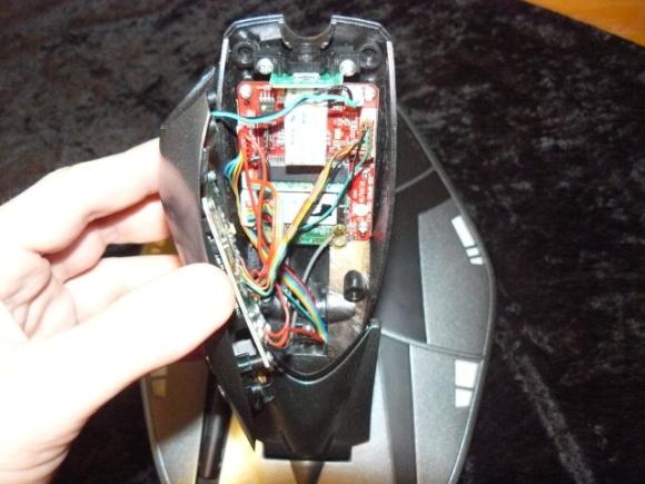

After removing four screws from the underside of Rovio's head, I found there's not a whole lot of space left over inside. However, there are two perfect little empty spots on either side of the camera just begging to be filled with extra lighting.
To power the lights in this location I had to fish two wires up through Rovio's neck. Indeed, this was the most fun of the whole project, and it took me about thirty minutes to get the wires into place. I'm pretty sure that further disassembly of the neck could have made this easier. I found it much easier to stuff the wires, one at a time, up from the bottom of the neck (rather than down through the head).

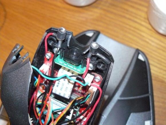

Once the red and black wires were through the neck and into the head area I soldered the red wire directly to the positive leads of the LEDs (in parallel via a Y split). The black wire is connected to the two LED negative leads via the 5.6 Ohm resistors. After a bit of pushing and prodding wires into place the LEDs sit fairly nicely and it was time to cut the plastic housing to accomodate them.
That's It!
Now it's time to stuff all this new wiring into place and close up the Rovio. This was the second most fun part of the project. Take care to not crush any of those skinny little wires, they probably wouldn't like it much. Once everything is in place, screw it all together, put the battery back in, and fire it up. Next time you hit the Headlight button in the UI you'll be able to blind whoever Rovio is looking at!

I added a bit of heat shrink to the outside of the LEDs. The idea was to prevent side light from washing out the Rovio's camera. It seems to have worked, but I can't prove it was necessary.
