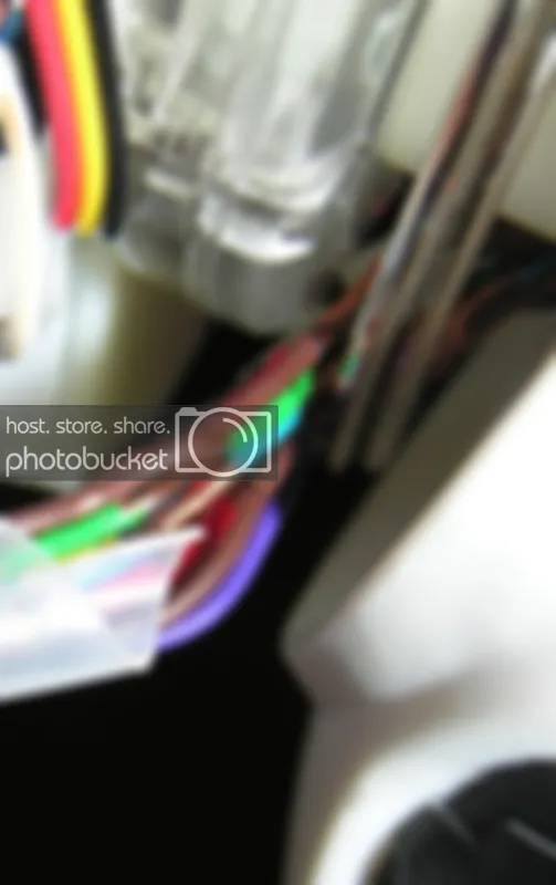

I got a brand-new RSV2, straight out of the box he ran for about three minutes and suddenly fell over and started shooting battery acid and smoke out of his foot. I call wowwee, they make me take pictures of the internals of everything and after three days decide to offer me no support because it was a gift given to me from someone who bought it on eBay. So now looking at this dead robot in my corner, I'm getting a little curious about why this happened and what to do, brand-new electronics shouldn't blow up batteries.
When I open her up I found a single bare wire in the same foot that malfunctioned(battery acid etc) touching the motor.
one whole cabling system is literally crumbling, all of the insulation. Other than that everything is fine, all boards still functioning (except programming memory), til one of the wires touches and the batteries blow up. What a humongous piece of crap.
somefrayed wires
I taped everything up for fun, he works, except now it appears he has a memory problem, he has none. Programming just will not work, though he appears to go through the motions. Any chance of me being able to repair? Wowwee sure isn't going to help me.

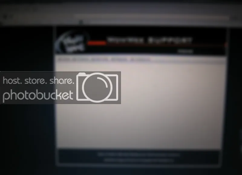

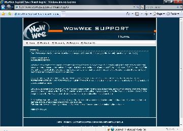

If you can't read the address bar this is wowwee's warrantee page, I think the blank page says it all.
I can't find any public posting of their warranty policy, can anyone else? I really can't believe they're blowing me off so bad.

Sepulchral
It must be your browser that you are using! I don't have any problems viewing it at all. I am using Vista, IE 7.0.6
Sepulchral
bah couldn't get the dimensions of the picture right!
nich0lai
^^ apparently the website doesn't work with Firefox. Good call thank you.
