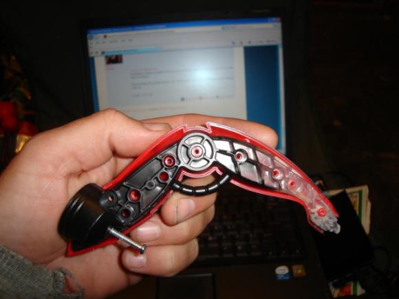

the tips are hard that's why I'm putting it in silicone. as for the motor movement. if you watch when it turns on it does a initialization check and looks for a switch to connect once it finds the switch it knows where the legs are and sends pulses out to move them. everytime it hits the switch it will recalibrate it's self to stay on track. the other motors uses a variable resistor to home in on the center and uses these ref points to calculate where it should be. I hope that answers your questions.
A little bit of hot glue will do the trick but what's the fun in that. I mean no making molds and pouring them into whatever your heart desires. thats what I like. In looking inside the leg there really is no room for any electronics. So I guess I'll have to cut out the inside and suport it with some heavy gauge wire so I can put a touch switch in it and LEDs.
