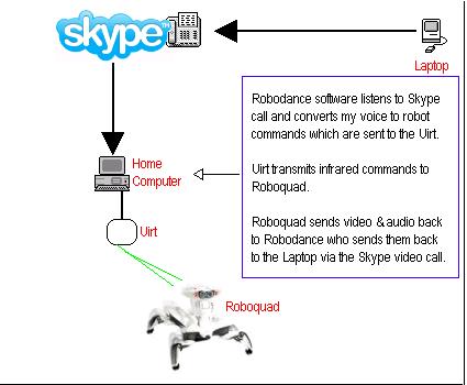

how do we connect roboquad on skype?
hello everyone! I posted this thread because I saw someone on youtube who connected his roboquad on skype and I would like to know how did he do that . (I have skype and a roboquad)

how do you download the roboquad software on the roboquad? (I can't find it on www.robodance.com )
MrScott
MrScott's picture
You don't. The software doesn't go on the roboquad. It goes on your PC, which communicates with the robot using an InfraRed transmitter (the UIRT).

how much is an UIRT and where can I find one?

You may want to hold off on the UIRT and wait for Robodance 5, which will support the much more inexpensive WowWee Roboremote (but don't buy anything until Robodance 5 is released please).

do you mean I could remplace the UIRT by a roboremote when robodance 5 is out?

Yes.

THANKS roshler,but I still don't know if I need a camera to run robodace 5 (and what kind of camera)
also, i'd like to know if I can use this system with all the robots of wowwee robotics because i'm maybe going to have a femi' or or a tri bot . please give an answer to all my questions.

All your questions are answered here:
http://robodance.com/skype-robot-demo.php
Please read it carefully.
