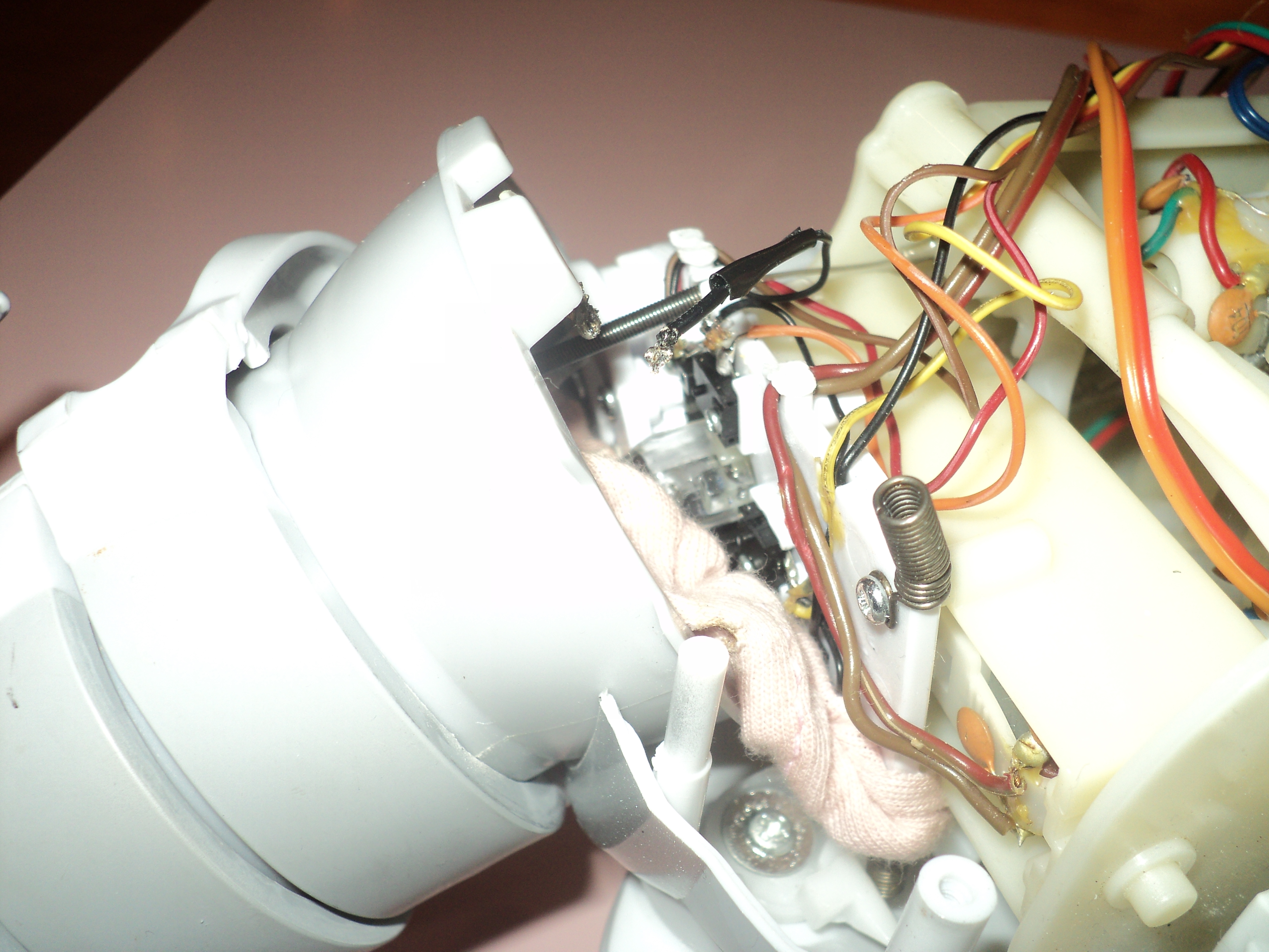

Here are some pics of the neck electronics:

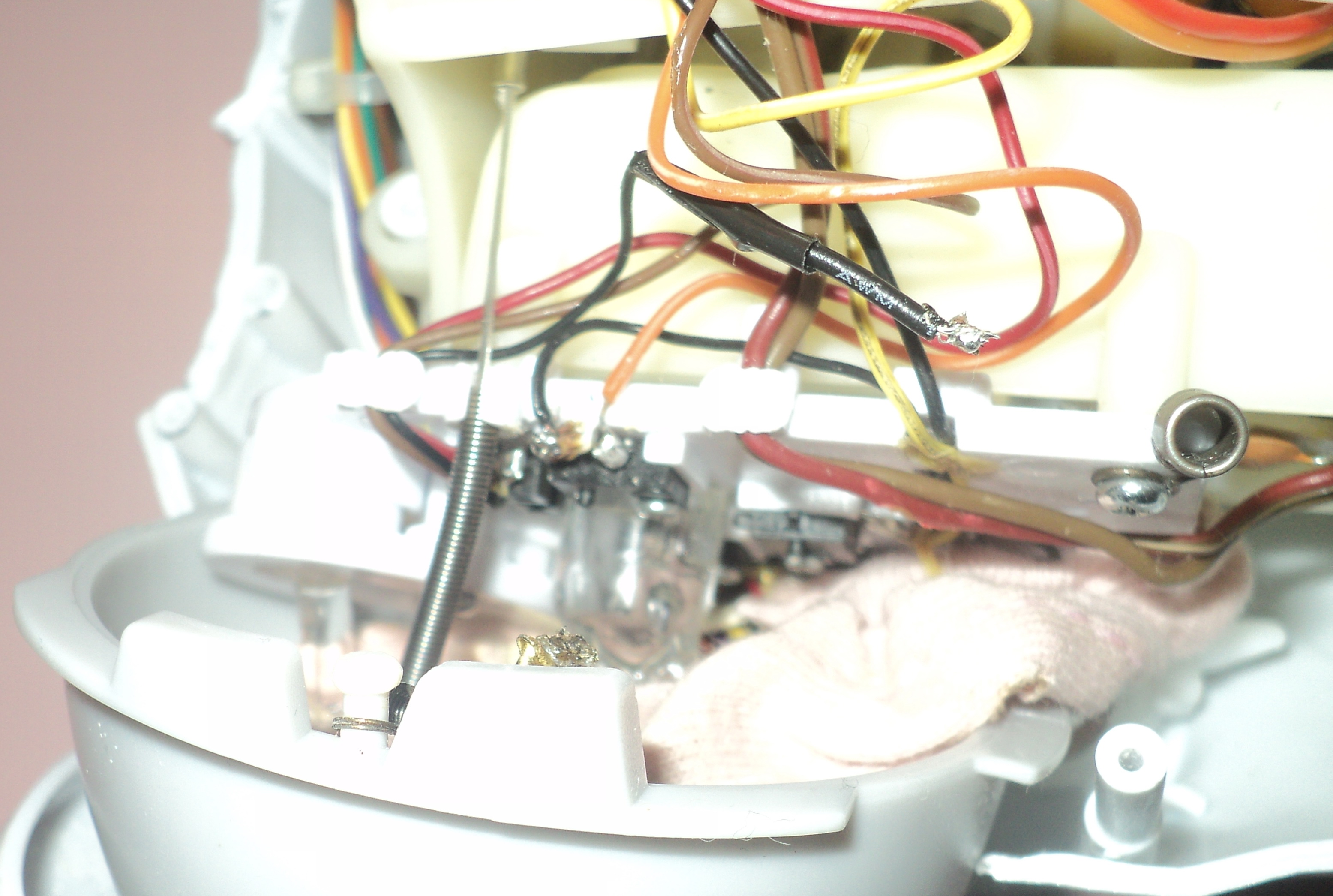

The Man
The Man's picture
And one more. The loose black wire was short, so I soldered an extension onto it. I simply cannot find where it came loose within the proximity of the wire's length. Baffling!

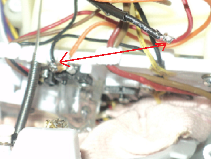

hi.is it possible that the two black are on the same soldering together.

hi nomad,
thanks very much for your suggestion! i thought it had come loose on some empty terminal, and never thought that it could be soldered to the same terminal as the other black wire. i soldered the loose wire to that, and voila! it works now. thanks very much for your help -- you made my day !!
