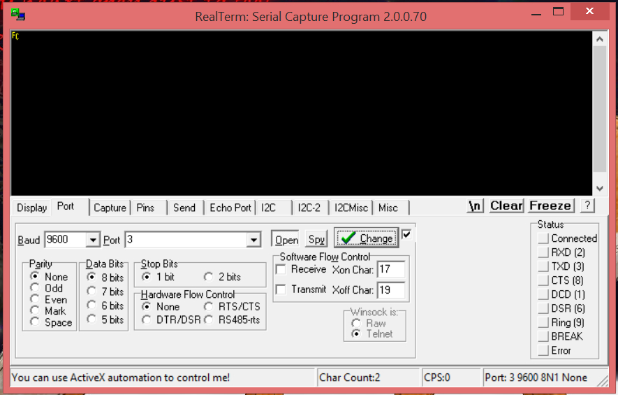

When this hack was completed, I plugged the chip into the USB port, and then opened realterm while the battery was disconnected. When I connected the battery to the dog, realterm shows this FC symbol, and I have no idea what it means even after extensively searching Google. Does anyone know what in the world this FC symbol means?

I know I need a cartridge with a CROMINST bootloader on it to run i cybie programs to the serial port, but I don't think the walk up charger cartridge has it. I was able to get a hold of the CROMINST BIN files, but I am not entirely sure how to get them on the cartridge because I am a complete newbie when it comes to robotics. Also, finding a cartridge with CROMINST preinstalled is almost impossible as finding the walk up charger was hard enough. Is there any way to do this through the serial port or other methods. There are a ton a arduino bootloader burning tutorials out there, but they are very specific for arduino and I doubt they will work for I cybie. If anyone knows how to help me with this, it will be greatly appreciated.
