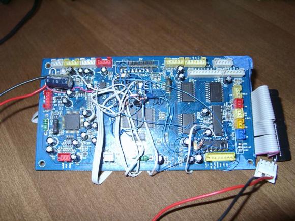

This the first of four articles about adding a "parasitic" microcontroller to the WowWee Elvis Alive that allows control of this device from an external PC via a serial interface. The external PC is also the source for the audio for the Elvis Alive speakers. This hack allows the Elvis Alive to either function in its original "Elvis Alive" mode or in the new "parasitic" mode of being controlled externally. Once you perform all the surgery to the Elvis Alive main CPU board, you can reinstall it and still (if all goes well) have a completely functioning unit! The only sacrifice in the original "Elvis Alive" mode is a cost in battery power since the new circuitry will still be present. So, the AC adapter is recommended, or you can add an external switch to turn off power to the added microcontroller board if you wish. The image below shows the modified main board reinstalled along with the added custom microcontroller board mounted to its right. All images for this four part article can be downloaded in a higher resolution from here (http://www.mediafire.com/file/tdkncywmzld/PCElvisImages.zip ).
Installed interface with parasite processor

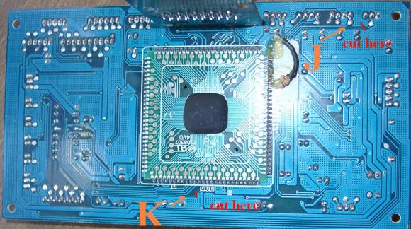

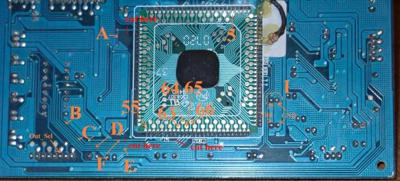

STEP 2:
Lay the just extracted main board down on a soft surface such as a folded up towel with the memory card interface sticking up and proceed to cut the 6 signal traces (A,B,C,D,E,F) shown in the picture below. These traces connect to the CPU pins (5,63,64,65,66,and 55). I used a x-acto blade and just made many repeated short strokes. You definitely want to avoid cutting any thing else doctor. These six signals do the following:
signal A (CPU Pin 5) - CE line enables/disables the control signals from the CPU
to the motors
signal B (CPU Pin 63) - START1 line enables communication with the SNAD01
converter on the main CPU board.
signal C (CPU Pin 64) - START2 line enables communication with the SNAD01
converted in the head.
signal D (CPU Pin 65) - CLOCK line to clock the data to/from both the SNAD01 A/D
converters.
signal E (CPU Pin 66) - DIO line is for data to/from both the SNAD01 A/D converters.
signal F (CPU Pin 55) - routes the external audio input (front audio jack) to the
speakers
STEP 3:
Locate a length of these traces (except F, we will get it off of a connector pin), out from the CPU where they can be scrapped free of their protective covering. Use something dull like a small screw driver or an instrument that is pointed but not too fine of a point. You want to make repeated scrapes with it over the targeted area of trace until about 1/4 of an inch length is exposed (you see shiny copper) but not cut the trace. Make the exposed trace areas not adjacent to each other (staggered) so that shorts are less likely in the next step.

Pictures of my completed board are shown below. Not pretty but functional!
