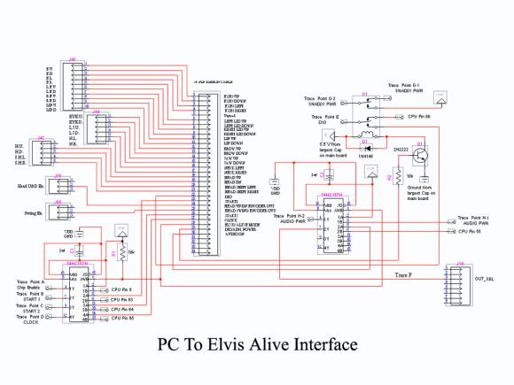

The list of the items needed build the interface is as follows:
2 - 74HC157 (16 pin DIP, 4 x (2 to 1 multiplexer))
1 - DPDT 5V Relay (DIP style)
2 - 10K 1/4 watt resistors
2 - .1 uf capacitor (DIP mount preferred)
1 - 2N2222 transistor
1 - small signal diode such as a 1N4148
1 - 2 pin connector to PC board (to power the added microcontroller board, in step 2 )
1 - 34 pin cable (I used an old floppy cable from an obsolete PC)
30 gauge wire wrap wire
22 gauge hookup wire for connecting power (red and black colors)
Silicone glue (aquarium sealant or similar)
wire wrap tool, soldering iron, solder, X-acto blade, etc
For the "lite" version, a 34 pin ribbon cable and a two wire power connector to go to the microcontroller board will do the job!

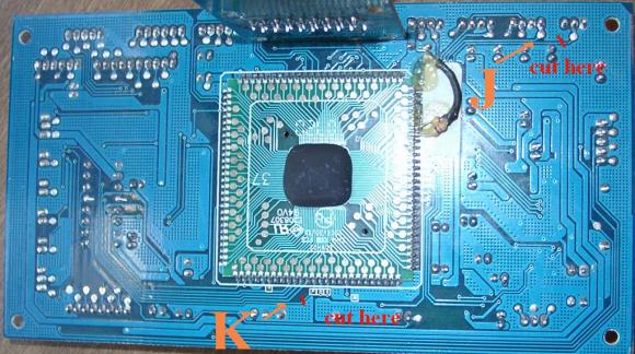

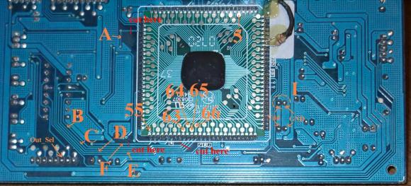

Lay the just extracted main board down on a soft surface such as a folded up towel with the memory card interface sticking up and proceed to cut the 6 signal traces (A,B,C,D,E,F) shown in the picture below. These traces connect to the CPU pins (5,63,64,65,66,and 55). I used a x-acto blade and just made many repeated short strokes. You definitely want to avoid cutting any thing else doctor. These six signals do the following:
signal A (CPU Pin 5) - CE line enables/disables the control signals from the CPU
to the motors
signal B (CPU Pin 63) - START1 line enables communication with the SNAD01
converter on the main CPU board.
signal C (CPU Pin 64) - START2 line enables communication with the SNAD01
converted in the head.
signal D (CPU Pin 65) - CLOCK line to clock the data to/from both the SNAD01 A/D
converters.
signal E (CPU Pin 66) - DIO line is for data to/from both the SNAD01 A/D converters.
signal F (CPU Pin 55) - routes the external audio input (front audio jack) to the
speakers
STEP 3:
Locate a length of these traces (except F, we will get it off of a connector pin), out from the CPU where they can be scrapped free of their protective covering. Use something dull like a small screw driver or an instrument that is pointed but not too fine of a point. You want to make repeated scrapes with it over the targeted area of trace until about 1/4 of an inch length is exposed (you see shiny copper) but not cut the trace. Make the exposed trace areas not adjacent to each other (staggered) so that shorts are less likely in the next step.
STEP 4:
Cut Six 1 foot lengths of wire wrap wire and remove 1/4 inch of insulation from one end. Using tape to hold each wire in place where the line can be soldered to the exposed trace, solder each of these wires to the main CPU board at the exposed traces for A,B,C,D,E. In some cases you may need to re-scrape after attempting to solder since the protective covering can burn back over the area. Touch solder the wire for trace F onto the soldered joint for the third pin of the 8 pin yellow connector (J14). This pin is labeled "out_sel" on the board and is shown in picture #1.

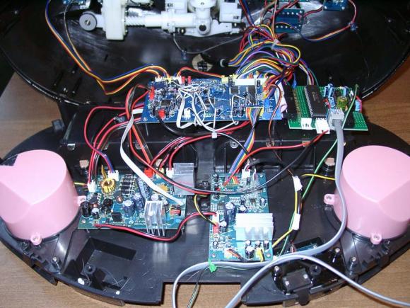

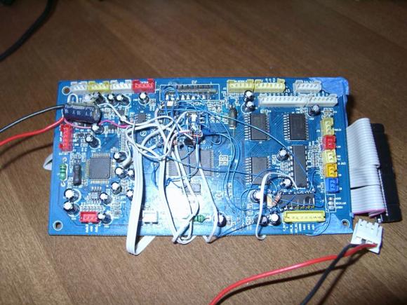

Check your wiring 5 or 6 times, check for shorts 5 or 6 times, then remount the CPU board in the base. It always amazes me how much I can miss wire something right under my own nose! Reattach all the connectors. Check for any cables that might get in the way of the mechanics and use some cable ties if needed. Power it on and Elvis Alive should still be Elvis Alive!
If you were successful, sit back and relish in the first step of your accomplishment. If not successful, sorry ,maybe you should have done the memory card hack. Go back and check your wiring again and also look for shorts again.

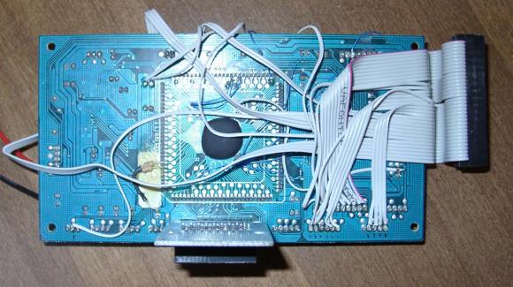

Pictures of my completed board are shown below. Not pretty but functional!
This completed interface has the following signals. All signals are @3.3 Volts. All but 22,24,and 25 are inputs.
Pin Signal Name
1 EYES UP
2 EYES DOWN
3 EYES LEFT
4 EYES RIGHT
5 Unused
6 LEFT LID UP
7 LEFT LID DOWN
8 RIGHT LID UP
9 RIGHT LID DOWN
10 LIP UP
11 LIP DOWN
12 BROW UP
13 BROW DOWN
14 JAW UP
15 JAW DOWN
16 NECK LEFT
17 NECK RIGHT
18 HEAD UP
19 HEAD DOWN
20 HEAD SHIFT LEFT
21 HEAD SHIFT RIGHT
22 DIO
23 START1
24 HEAD UP/DOWN ENCODER OUT
25 HEAD SWING ENCODER OUT
26 START2
27 CLOCK
28 ELVIS ALIVE MODE
29 DIO/AD01 POWER
30 AUDIO ON
Here's an explanation of how this interface is used.
When the ELVIS ALIVE MODE signal is set high, Elvis is his old self. This signal is pulled high with a 10K resistor so that everything functions normally without anything plugged into this interface. When the ELVIS ALIVE MODE signal is pulled low (Parasite Mode), the 74HC157's switch all the signals of the traces you cut from the on board CPU to the external CPU. One of the signals switched is the Chip Enable for the on board 74HC574's which is switched to being a High level which disables the '574s. These chips drive all the motor control signals for the Elvis Alive. When these chips become disabled, Elvis essentially becomes paralyzed at this point and in his own words "leaves the building". So always set the ELVIS ALIVE MODE signal low before the external microcontroller's signals become outputs (keep in high impedance mode until used). Also return them to high impedance mode when returning to Elvis Alive mode.
All the motor control outputs act in toggled pairs to run the 10 different motors forward or backwards. The motor signals are all active high and should be run in a clocked duty cycle to control the speed. The duty cycle for the stock Elvis Alive was observed to be about 130HZ. For the controller in my hack I will divide the control of this into 1/10th of a cycle so my main control loop will run about 1300 times per second.
The limits for these motors must be observed by the control software to know when to stop. Otherwise the stripped gear noises may become unpleasant for some motors. This is where the existing onboard A/D converters can also be utilized for 8 of the motors. The onboard SNAD01A A/D chip has a 250KHz conversion rate with 8 bits accuracy. It is similar enough to the SNAD01B,C versions that the pdf specification for the later versions can be used for programming them. ( It can be found here at http://datasheet.digchip.com/805/805-3-152276-SNAD01B.pdf) I never could locate a pdf for the (A) version of this chip. Just remember to initialize the 4 bits of the SNAD01 control register to all 1's (my experience). Otherwise, the results are the same as documented. The 4 signals DIO, START1, START2, and CLOCK are used to read both of these A/D chips. There is one on the main board and one in the head. The DIO line is special in that it is used as bi-directional to both send commands and receive the data. This is why a relay is used to switch this signal between modes instead of the 74HC157's like the other control signals. So in order to read the A/D's externally, the relay must also be activated and to do this you would set the DIO/AD01 POWER signal to high.
The second set of contacts on the relay are not wasted and are used to switch power back on to the A/D converters and to the audio amplifier since the on board CPU will turn this power off if it cannot control the unit (because the interface cuts off the control signals). This is also useful to do an initial reset to the A/D's by turning power off and sending all other input signals to the A/D's to a low level for a short time (1-2 seconds).
There are encoders on two of the motors for head up/down and swing movements instead of A/D feedbacks. The HEAD UP/DN ENCODER OUT and HEAD SWING ENCODER OUT signals for these encoders are the only two outputs from this interface other than the DIO signal. These are just clock signals that must be counted to be useful so sending them to interrupts on the added microcontroller would be a good way to keep track of these two motor movements. In addition there are four limit switches for these two motors that are read from one of the A/D converters. These read 255 as OFF and 0 as ON. You must perform an initialization sequence in your microcontroller code using these switches to calibrate your encoder counters. Then you can stop movement before you reach these switches using your encoder counters.
The AUDIO OUT signal is set to high to route the front audio jack input to the speakers. So this can act as a audio mute when needed. And I might add that you can get a BIG BOOMING voice from these speakers from a computer verses the weak voice put out by the stock unit.

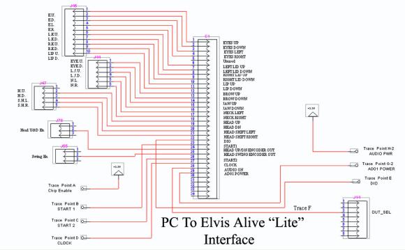

The Lite Version of This Interface
The last picture below is the "Lite" version schematic using just a 34 pin ribbon cable. The only difference in this interface version's signals is that the ELVIS ALIVE MODE signal is no longer present so the stock Elvis has left the building and he ain't coming back. I did wire up this "lite" version as well and it does work. All you will need to do is cut the 8 traces shown by the red lines in the pictures, add a two pin power connector off the large capacitor for your controller board described above in step 16 and solder the 34 ribbon cable lines to the board per the schematic. Remember to keep the orientation of the cable as described above in step 14. Note that the C, D, and E traces can instead be soldered to pins on the bottom of J21. Also the H-2 trace can instead be solderd to a pin on the bottom of J73 and the G-2 trace can instead be soldered to a pad that resides on the bottom of the board near J73. So you can reduce the number of traces to two that you have to scrape clean to solder wires to (just A and B). Just use your ohmmeter to verify the correct spots. This puts all the ribbon cable connections to the bottom of the CPU board which makes for a neater and a safer hack.
